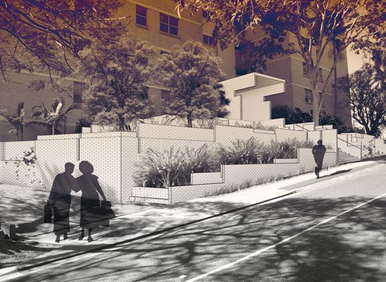

Is it possible to create a SKetchup style or White card type render in archicad? I basically want a Hidden line type perspective but with vectorial hatches displayed, ie blockwork, weatherboard lines etc. as well as shadows.
I've attached an example of what I mean, any help would be much appreciated!
Cheers

HI,
Use the sketch render mode and start with the pre-set style Kooh-i-Noor.
I your case uncheck shadows.
