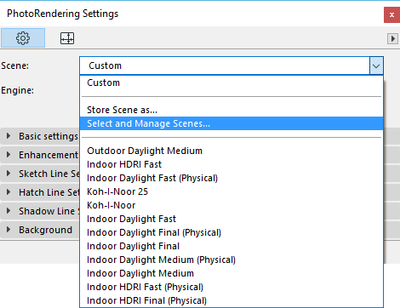

  1. Select the Sketch Engine in the Document/Creative Imaging/PhotoRendering Settings... dialog in the Engine drop-down menu.
  2. Choose the desired style by selecting a Scene in the Scene drop-down menu.
  3. Set further details on the lower parts of the PhotoRendering settings window as discussed below in this article.
  4. Create a PhotoRendering by hitting the PhotoRender Projection button at the bottom of the PhotoRendering Settings window.

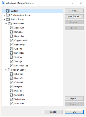

The Sketch Rendering Engine provides a number of preset styles called Scenes with a preset combination of parameter values. You can access all available Scenes via the Select and Manage Scenes... command.
You can customize these Scenes by changing the preset values and overwriting them keeping the original name of the Scene or storing them under a new name.

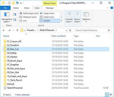

  • Line Styles: Each line type is represented by a dedicated folder with a set of bitmap images. These sets can be extended with similar scans of scripts using any graphic device. To get the best sketch effect, it is recommended to scan a large variety of line lengths, as the program will choose randomly among these styles when reproducing lines in the rendering.
Go to the Archicad folder at Add-Ons > Visualization > SketchTextures.

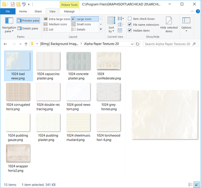

  • Paper roughness can simulate the effects of bumps on scans of real "rough paper". Normally, bumps are generated randomly by the rendering engine; however, for best results, it is advisable to use a background image with a predefined alpha channel for the bumps
NOTE: There have been changes in the handling of Paper Roughness in Archicad 20, so rendering results may be different from what you got in Archicad 19. In general, the lines of the rendered image will be more faded in Archicad 20 than in Archicad 19. You might need to set Paper Roughness accordingly.
  • You can find some background images in the Archicad Library 20/[BImg] Background Images 20/Alpha Paper Textures 20 folder. Check the Use background alpha channel box if you use such a background image.
The sketch engine can detect these bumps and fade or erase the sketch lines in this area depending on the settings of the Paper Roughness slider. This setting has no effect if no background image has been scanned with the alpha channel. For samples, go to the Archicad folder and open Archicad Library 20/[BImg] Background Images 20/Alpha Paper Textures 20. Try loading any of these background images from Document > Creative Imaging > Photo rendering Settings > Background. These tend to work well with wax sketches; the effect is less natural if using a brush effect.

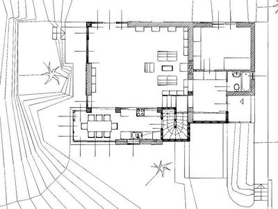

Step 1
First of all, you have to adjust the layers in your plan so that you only see the lines that you want to see later in 3D. Hint: draw a rectangle around the extent of your project - this will come in very handy later when resizing the object to your floor plan!
Step 2
Place all the plans you would like to create Sketch about on Layouts.
Step 3
Publish or save the correctly resized and scaled Drawings to DWG or DXF formats. In the DXF-DWG Translation Setup dialog (File/File Special) you can add the export/import options like Pens and Colors, Penweights, or Line types. (You'll recognize that everything is broken down into the most primitive elements (lines, arcs, hotspots). This is necessary in order to see them later in 3D.) Be very careful about the Drawing units at this save operation, the following chart contains the needed conversation values.
Step 4
Now open this DWG file in Archicad. Make sure to set the drawing scale back so that 1 drawing unit in AutoCAD equals 1 meter in Archicad. So if you did the previous step correctly, the DWG file is now in the correct scale and you don't need to bother with scaling when saving and opening the DWG file. Now in Archicad, you might want to do any modifications needed before again saving it as DWG. For example, you might want to move the whole drawing closer to the ProjectOrigin or delete unnecessary HotSpots that have been generated. GiovanaBenvenuto_0-1674566655840.png
Step 5
Save this file as a DWG file. You can also overwrite the previous DWG file saved from Layout. Use the settings similar to your previous DWG save.

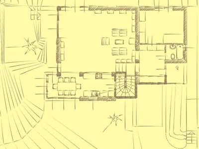

Step 6
Open this file as a Library Object in ARCHICAD. (File/ Libraries and Objects/ Open Object...) Browse for a Folder where you have saved the DWG into. In the appearing dialog, you can check the layers you want to import into ARCHICAD With the Save command or by closing the dialog save the Library Object under a new name into the Embedded Library or into a selected folder on your computer. Now you can select the Library Object to place it on the Floor Plan. Make sure to check the Enable Object Linetypes and Pens checkboxes are selected in the Object Selection Settings Dialog so they will appear in the same colors.
Step 7
Select the Object. Go to the 3D Projection Settings dialog box. The below picture shows how the Object will look in 3D in isometric projection. You should select Top View so it will look like a 2D view in the 3D Window. Go to the PhotoRendering Settings dialog box. Select the Sketch Rendering Engine and click the Options... button to enter its Subdialog where you can select and customize the kind of Sketch Rendering you want to apply. Also, set the desired PhotoRendering size and background colors for your Rendering. You may also find the file " SketchPreset .txt" located in the "Add-Ons / Visualisation / Sketch Textures" folder. You can copy and paste a whole Preset into another portion of the file and modify it to your preferences or save in it a Sketch setting set that proved great-looking for you. Make sure to create a copy of this file before you start modifying it. Here are some final sketch results from a Floor Plan of another Project:
Important Note
When selecting the Sketch style to be used, please make sure that you set the "Air perspective" value under the "Enhancements" section to 0%. Any other value will not give correct results. The reason is that when you use a Parallel projection (such as Top View) the sketch rendering engine doesn't have information about how far the 3D data is from the viewpoint. It is as if it was at an infinite distance therefore any Air perspective value will make the lines disappear in the Sketch rendering.
