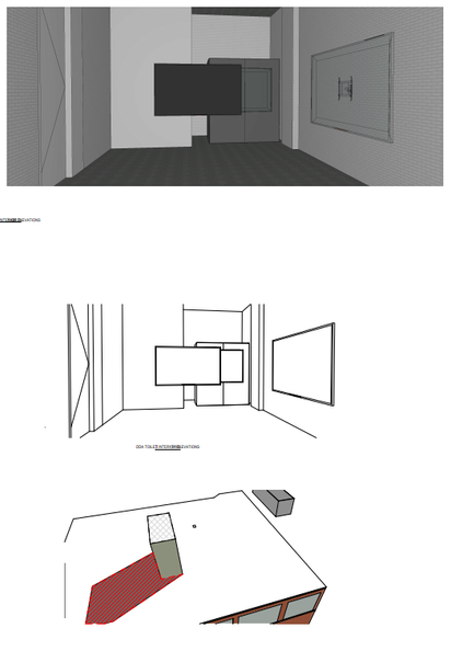

Due to the vectorial nature of fills etc, our PDFs end up lagging and freezing, often to the point where some are unusable. There are workarounds, but these usually involve substituting certain fills for plain or simple ones. That's often not an option when trying to visually annotate different building elements. My mindset is "we've got the resources let's use them". There's websites where you can flatten PDFs but hit and miss success.
Our current most efficient work around is; once we have published the PDF from Archicad, we then open the PDF in Adobe or Foxit and print to the "Microsoft Print to PDF" virtual printer, we then tick "Print as Image".
My wish is:
In the Publisher, under Document Options, there should be a "Print as Image" option like above, to avoid the below...

this  drawing gets 25 MB !! as pdf!! not okSchermafbeelding 2026-04-17 092901.jpg

OK, I think it's important to understand this so we can clarify the wish, because I have been dealing with this for a long time.
So the vectorial fills that come from Archicad - 'scripted vector fills' (see attribute image below), vs symbol fills, vs image/ other fills (as shown in your example) etc. all behave differently in PDF, because they're all effectively being re-scripted in PDF language when you print. This topic also bleeds into DWG hatch conversion if you have ever experience the explosion of %fills the theory also applies here.
You will also notice that there are performance advantages to using publish to PDF vs print to MS PDF vs Adobe Print to PDF vs ... Personally, I see advantages to print to MS PDF because it's very efficient at the scripting/ coding (e.g. when you convert pdf back to linework it can save time over publish to PDF because lines are joined). But I digress... Archicad/ GS should clarify what the publisher set does vs the save as.
*** Archicad should have Raster vector images (with various DPI) per the wish described above and potentially convert/ replace fonts.
There's also a bunch of PDF compression tools that you now see in Adobe/ Bluebeam etc. that should be implemented. ***
And, maybe this should also be available on import when embedded in the file.
To clarify the workflow I use -  the above I would do as a series of (design option) 3D doc cutaways, saved as PMKs, placed and published as PDF.
Personally, I use 3D docs to PMKs because they're more reliable, faster and lighter, but each to their own (image 2 below showing a range of vector fills).
When I do use PDF's it's more because it get's used in other documents/software such as presentations, specifications, reports and schedules.
Where this would be most useful is large masterplans with diagrammatic hatching (particularly if you use grass hatch). It also shows up in A2 and greater plans, particularly in presentations where PMKs are impractical to setup and we would rather use live views or it duplicates an existing process.
Hit me up if you want to know more.
