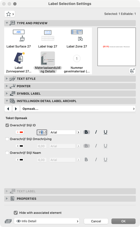

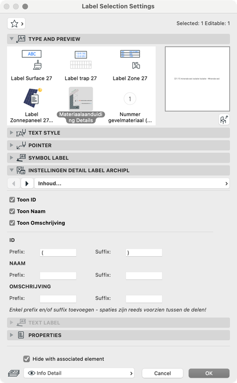

We recently created a label for a client, allowing them to display Building Material properties (ID, Description, Name) of the 'contents' of a composite - in a Detail. The label is associated with the (building material) fills in the 2D Details, derived from the 3D model. Some improvement to be added (scaling text for example...), but very "BIM" as the contents of the label do update when a Composite definition or Building Material definition is altered...
