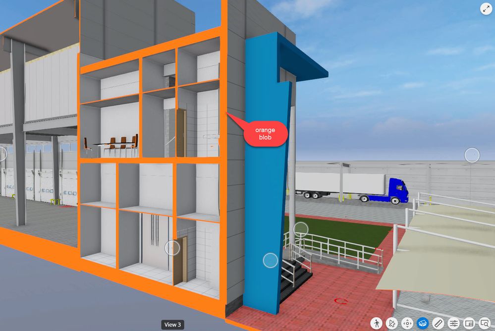

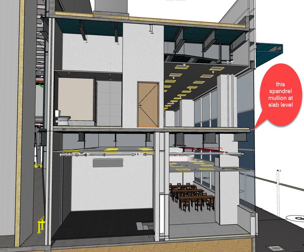

While setting the colour of the cut elements section in BIMx is a great feature, for clarity and checks on site - where BIMx is supposed to be used the most - or with the subcontractors, or anyone else not using Archicad, it is ESSENTIAL that the cut elements show with the Building Material fills.
This is especially important in composite elements with air spaces

Thank you for bringing this up. We recognize that displaying building materials on the BIMx cut plane would be valuable. There are some technical challenges that we plan to explore. This idea is under consideration.
