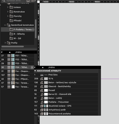

I partially agree with this wish that there should be a button to go to the attributes (building materials from composites, surface from building materials etc.) so we don't have to save current setting, create new attribute and then go back.
But about your text where you want to simply go to surface of a building material, you can do that already with attribute pallets.
There you can simply double click on a attribute you wish to edit and you are also able to show related attributes and open their settings as well.
