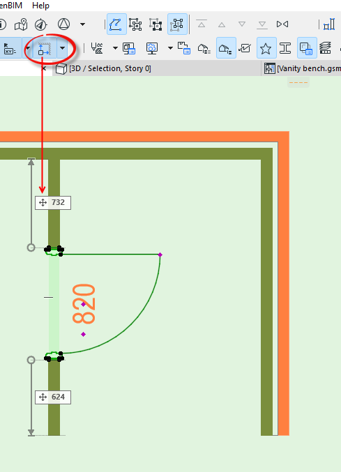

In version 28 you have distance guides.
Makes it super easy to adjust the position of the door/window.
Does that suit your needs?

Hi Barry,
this works great per instance. However if it were an object attribute/parameter you could set the parameter globally (to multiple instances) and or filter/check for doors where a certain distance to an adjacent wall is not met.
It could also act as a "rule" - minimum distance to closest wall - door placement, if the user would decide to have such a rule.
