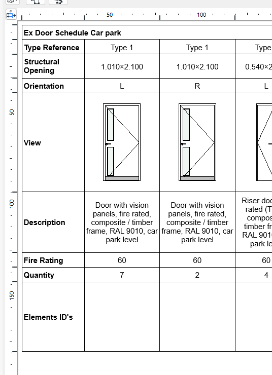

I would like to have the option to group all the Element ID's in one cell, based on the Type reference or Orientation. For example, in the image attached I have 7 doors of Type 1 that open on the left and 2 that opens on the right.
I would like to be able to add a row which displays all the ID's for that type of door in one cell. If I add now the Element ID as a field, it further breaks the doors into individual columns, which is not nice to see if you have over 100 doors.
Adding them manually in a Custom Text row is also very time consuming and might also lead to errors.

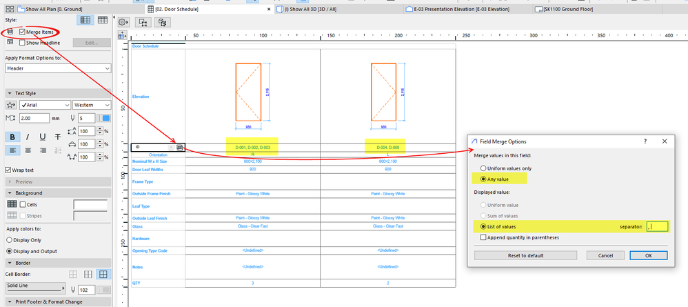

You can already do this by merging the cells.
Make sure 'merge items' is on.
If this satisfies you, let me know and I will close the wish.
Chris_Lz
Oh, that's great Barry. Thank you.
Excellent, it worked perfectly.
