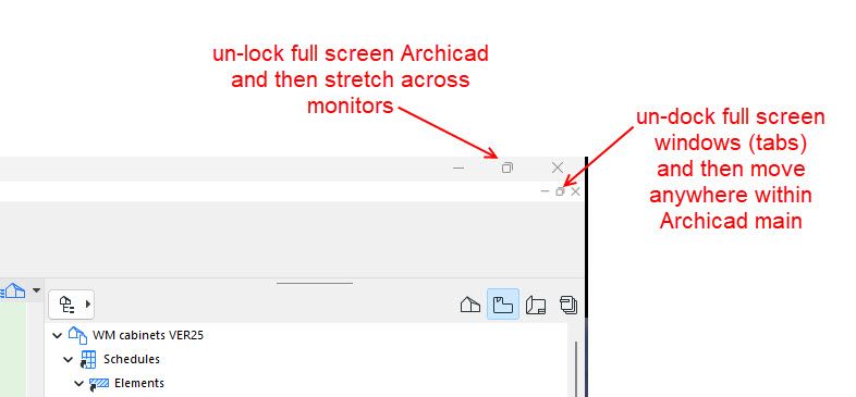

I, along with many of my colleagues, would LOVE if ArchiCAD allowed us to work with multiple tabs open across our monitors. For example; if i were to be working away on a detail and need to continuously reference a plan, instead of flicking between the two tabs, I want to be able to simply grab that tab and drag it across to my other monitor, allowing for a much smoother and more efficient work flow. This would be beneficial in a multitude of instances, but mainly when using 'trace' is a hindrance to the drawing, or when a file is large and takes time to load each view when flicking between them.
Imagine having a section open on one screen and an already complete section on the other, being able to copy and paste/drag 2d elements directly across. Basically, having detachable tabs would make my life as a daily archicad user one heck of a lot better.
Moderator edit:
This post merged with existing wish.
@gcollins
You can already have multiple windows (tabs) open on multiple monitors.
With Windows OS you need to stretch the Archicad application across multiple screens and then resize and reposition the view windows.
I believe on Mac OS you cn just drag to another screen - but I am not sure about that.
Either way the views are not updated until you click into them to activate them.
Which is what this original wish is about and why I have merged your wish with this one.
gcollins
@Barry Kelly
Any chance you could give me a little step by step how to resize and reposition the view windows? happy for the views to not refresh until i click it but id love to be able to have one section open on the left screen while working in another on the right. Can't quite work out how to have multiple view windows open once i stretch the archicad application across both screens.
I can only speak for Windows OS 
