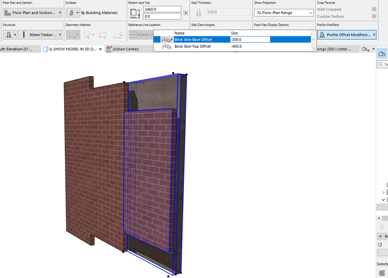

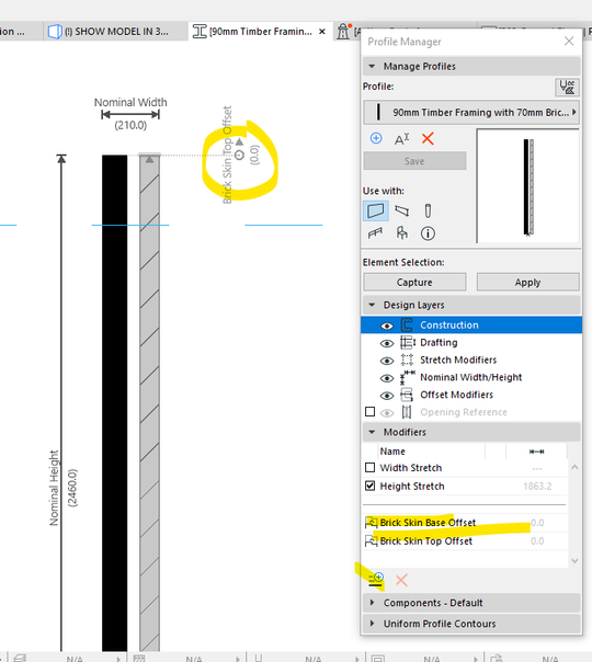

Hi @NigelMX
Not sure if this helps you, or if you already have tried out.
But if you select an instance of one of your composites, change the "structure" from composite to complex profile, you can then go in and set a custom modifier.
From that point onwards, any placed instance of this complex profile can have unique widths set.
In the example below I have set modifiers for height (top and bottom), no reason thou these can't be set to width.
One complex profile, mulitple variations.
NigelMX
Thanks Josh,
I have used profiles to control wall previously. It seemed to me it would be useful to increase the width of an composite element perhaps using a pet palette control
thanks anyway
Nigel
