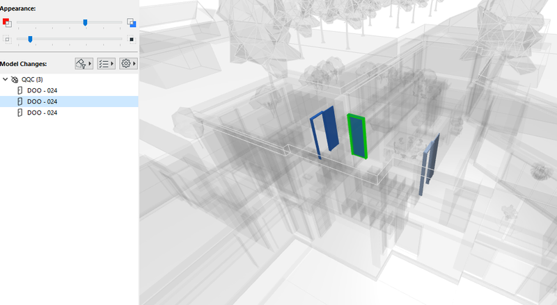

I would like to see a effort to consolidate all this control functionality in to one tool and base it on the same logic as the Find & Select tool.
My rather spontaneous concept idea for intuitive visibility control is a toggle between 'Show All' and 'Hide All' with an exception/inversion list based on Criterion Sets or Criterion Set Combinations.

As it turns out it could just as well have come from AC itself. Model compare already has not only it but also interactive listing of the criteria extension for overview and quick selection. Apparently GS doesn't consider it useful when actually designing/modelling and decided to put it in a niche. And given the current development I would not be surprised if we see it introduced on BIMx for mobile devices before it becomes part of the everyday workflow.
