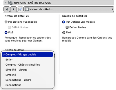

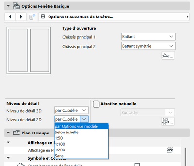

Hi everyone,
I want back the possibility to simply hide a window on floor plan, like it was in the past.
In the Windows Options, the Level of Detail 2D don't allow us anymore to select "None"??!!!!!!! It's like that since the new global library
Give it back to us, please!!!!

FYI, the MVO settings you see were originally completely missing from AC28, but were reintroduced in AC28 Library Update 2 minus the "Off" status. In AC29, they are completely missing again...
https://community.graphisoft.com/t5/Libraries-objects/Library-Update-2-MVO/m-p/658552
https://community.graphisoft.com/t5/Libraries-objects/AC29-Library-MVOs/m-p/695263
