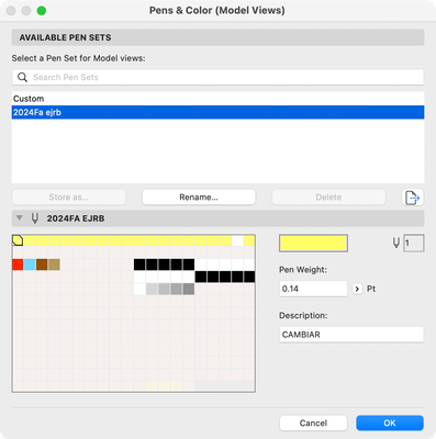

Currently line weights by color makes no sense.  Make weights of a line apparent when on the screen. and only use colors for colors.
Considering the high resolution screen we have today - why should it be a guess or have to remember a color to note a width.

I don't know why this needs to be a wish since you can already do it by editing your pen sets.
  • Everything uses black pens
  • Anything by GS that uses pens 1-20 (except 19) is yellow to highlight that it has not been edited.
  • Add colors as necessary and use GO's to highlight items

Simple, Pretend you are a newby to your template.
Without having to search which of these dark squares are 1.25?
Note as a new user I've seen a dozen templates, trying to remember all that is needed to work and just to add this is frustrating.
It would actually be quicker to add a list of the lines I would use on the template.
But I have a problem here - even then with the settings correctly set up - many of the lines do not look any different than the other

Eduardo Rolon
Some quick comments and FWIW I am not arguing against your wish:
  • The file shown is the one I use when teaching AC 2nd year architectural students (since 2005).
  • This is part of my template so it is available for all my projects
  • I started using Autocad around 1990 and one of the issues I have had is to adjust that 2020's CAD/BIM is not 1990's. This means that for current users they don't care, know, about specific line weight thickness, They have never used any technical pens. In that case the set up is:
    • first black square = any line that is not Cut or Uncut
    • middle square = Uncut
    • 5th square = Cut
    • In between are for exceptions
  • You always work with True Line Weight on and if it looks ok then it is, if not then fix it.

Eric Milberger
Ok another solution could be a 2nd dialog that would display your pens with a colored line with weight rather than a square that is incomplete.   It could include pen sets like you have.   A cheat would be a on screen drawing with this. However that would have limitations.
to edit the current dialog with a weighted line in lieu of a color would be an easier jump.
open the current dialog only represents the color an weight and style
