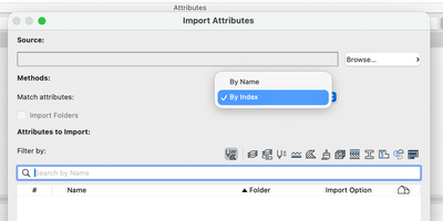

James B
You can already import via the Attribute palette by Index. Maybe it didn't default to that method.

Ok, so I assume that the one time I was doing broader scale updates to a file it must have been set to be By Name. This still comes back to the Attribute Palette being a downgrade from the Attribute Manager in most ways as:
1. The seperate buttons of the Manager are a lot more intentional than the dropdown of the Pallete
2. You can actually see and compare the temporary current state verse the import
3. You can check all pending Changes before finalising
