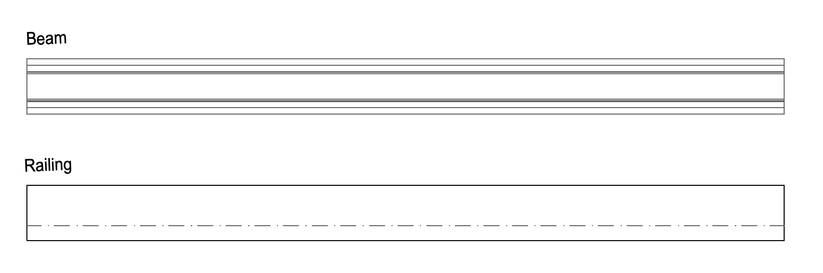

Modeling roads on a sloped site with the beam tool and a complex profile, when we have a curved road it can not be inclined, which is restrictive. It can be inclined if we used the railing tool, however this does not show the floor plan representation of the complex profile/road on floor plan, which is less productive than using the beam tool.
2D Representation of Beam VS Railing

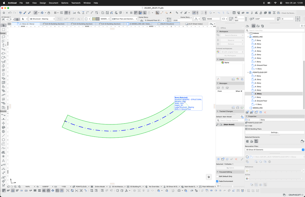

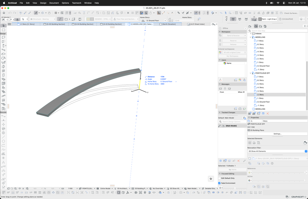

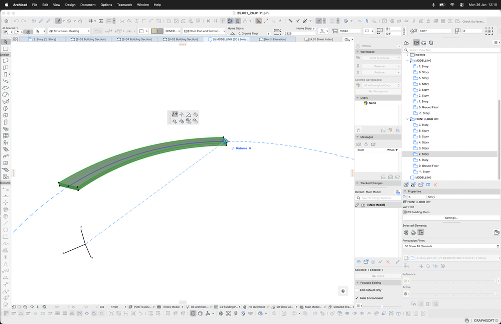

Bam and Column had been changed from version 23. Limitation,  if I create a curved beam in plan, I cannot elevate at the end or the beginning to create a sort of sweep... Big impact for me!
The only way to create a sweep is to convert to morph......no thank you
These improvements will facilitate design and surveys...
Please find attached the screenshots
