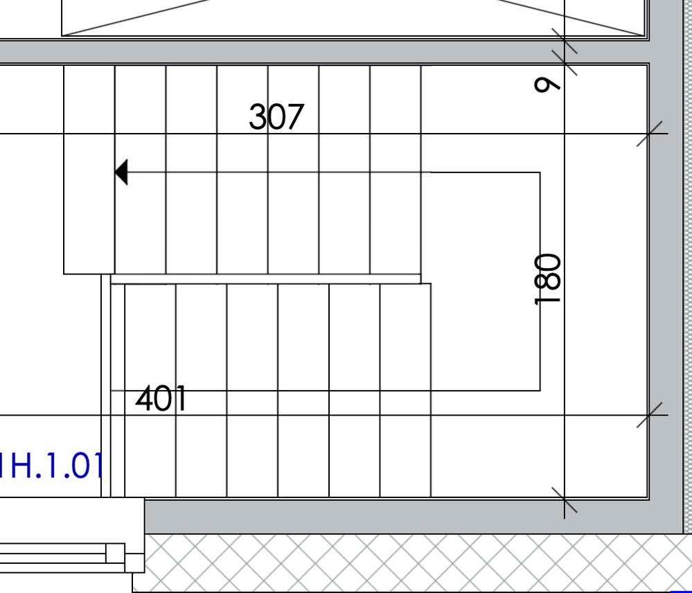

Make it possible to send a step of a stair to front/back individually
Freya

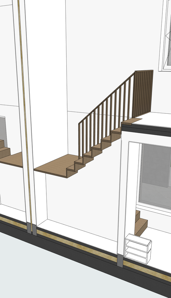

It is impossible to show the part of a stair that's above the slab, but hide the part that is underneath it.
If you could choose to send the steps to front/back individually this would be solved.

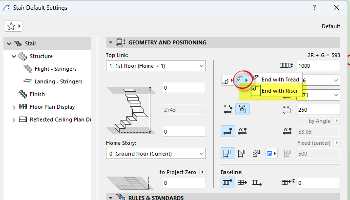

Do you want to hide that top tread on the stair?
There is already an option to do this in the stair settings.
Is this what you want?

@Barry Kelly, that's not what I meant. I want to see the top tread, but not the first step at the bottom because this step is hidden underneath the slab.
@Laszlo Nagy  Performing a SEO with the stair as target isn't the solution as well.
I may have been unclear but I'm talking about the floor plan.
I want to have this result but without using fills:

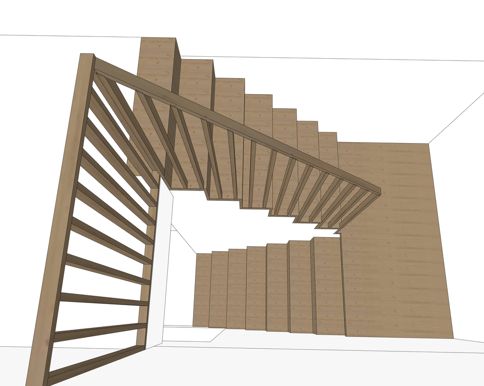

I do want the top tread showing because it's a different material than the slab, like you see in 3D.
I gave the slab a fill, but that hides the top tread as well. The issue is that I want to hide the bottom tread because it's underneath the slab but show the top tread.
