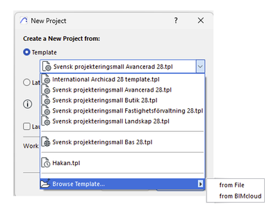

This is someting that I also wish for. The option to open a new project with a tpl located on the bimcloud.
It could look something like this.
