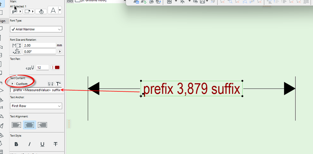

when dimensioning the room there is no adjustibility in the text dimensioning. In our case we wanted to add arrows closer to the dimension. In other cases you want to add sufixes to the dimension like the type of measurement(mm/cm/m).
2 Comments
The arrows (markers) will always be at the extents of the dimension line, because they are indicating the points you are dimensioning.
But a prefix and suffix you can add with custom text.
CSpijksma
when working with large amounts of measurements it takes a lot of time to change all to custom text. A "pre-pefined" pre- and suffix in the dimension tool would make it a lot quicker
