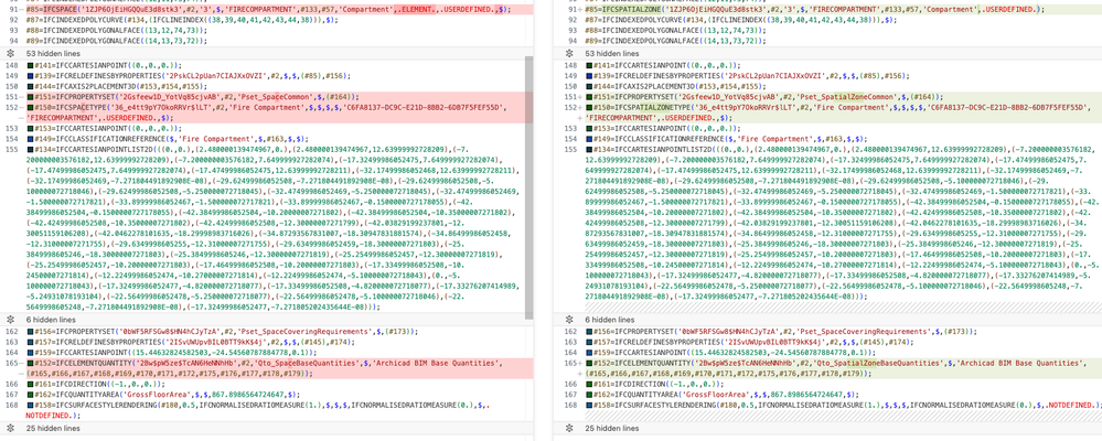

Alas, I don't see any changes with Archicad 29 to be able to export an IfcSpatialZone from Archicad (preferably using a Morph or an Archicad Zone). Only Spaces and Morphs can become IfcSpace. You can create IfcZone (= grouping without geometry) in the IFC Project manager. But since IfcSpatialZone can have its own geometry, it needs to be generated from a modelled element. The Type Mapping preset in the IFC Translator does not give access to this class.
stefan
FWIW, I exported a single Zone as an IfcSpace and manually changed the IFC codes generated from Archicad (which was not that hard)
  • Replaced IFCSPACE with IFCSPATIALZONE
  • Removed attribute 9 and 11 (as they don't exist with IFCSPATIALZONE)
  • Renamed Pset_SpaceCommon into Pset_SpatialZoneCommon
  • Renamed IFCSPACETYPE with IFCSPATIALZONETYPE
  • Surprisingly, I didn't have to remove attributes, as IFCSPATIALZONETYPE has the same structure as IFCSPACETYPE
  • Renamed Qto_SpaceBaseQuantities into Qto_SpatialZoneBaseQuantities
  • I didn't remove any of the not-defined quantities from this set, as I preferred to have them anyway (and I find it strange that SpatialZone lacks them).

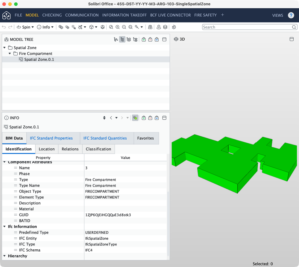

Tested with BIMcollab Zoom and Solibri and nobody complained about it.
Agreed that it is a bit of a hack and not 100% valid IFC at the moment, but it also proves that the change is not that fundamental, IMHO.
