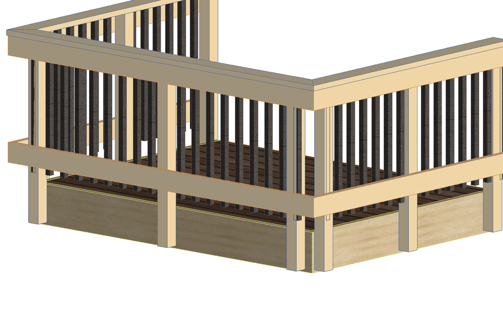

For the wood deck railings that we construct in our area, the inner post and posts are offset for the center of the railing axis.
The railing has a 2x6 top cap with a 2x4 (or 2x6) horizontal at the top and bottom of railing. The horizontal rails are attached to a 4x4 post that is beneath the 2x6 top cap. The 2x horizontal is 1.5" and the 4x post is 3.5" with a combine dimension of 5". The 2x6 top cap is 5;5: wide and sits on top of the members with 1/4" overhang on each side.

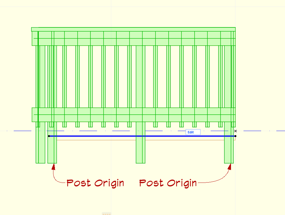

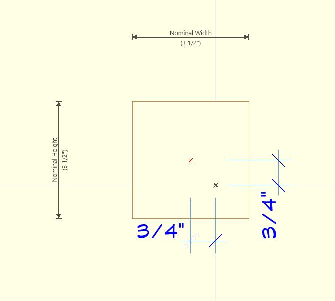

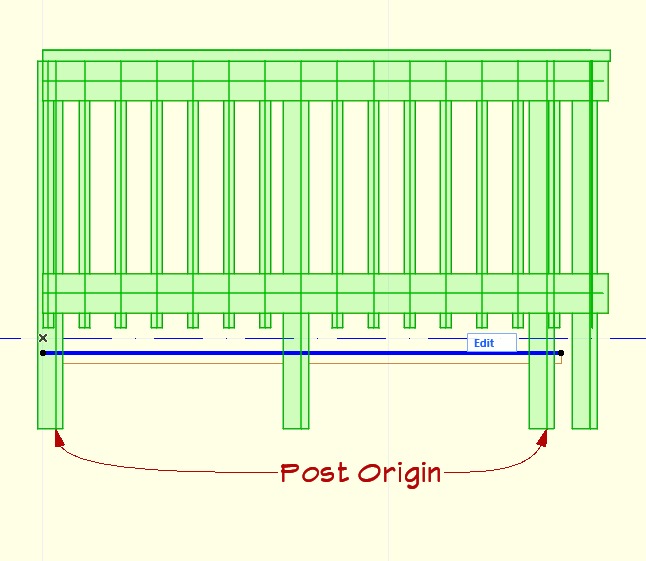

I attempted to create 4x4 post with an offset in the centroid with the Profile tool and :Use with:" Column + Railing. This profile with the offset worked for the inner posts, but the end posts would only work at on end since the other end is a mirrored item it was offset in the incorrect direction.
PROFILE
Side Elevation
Front Elevation

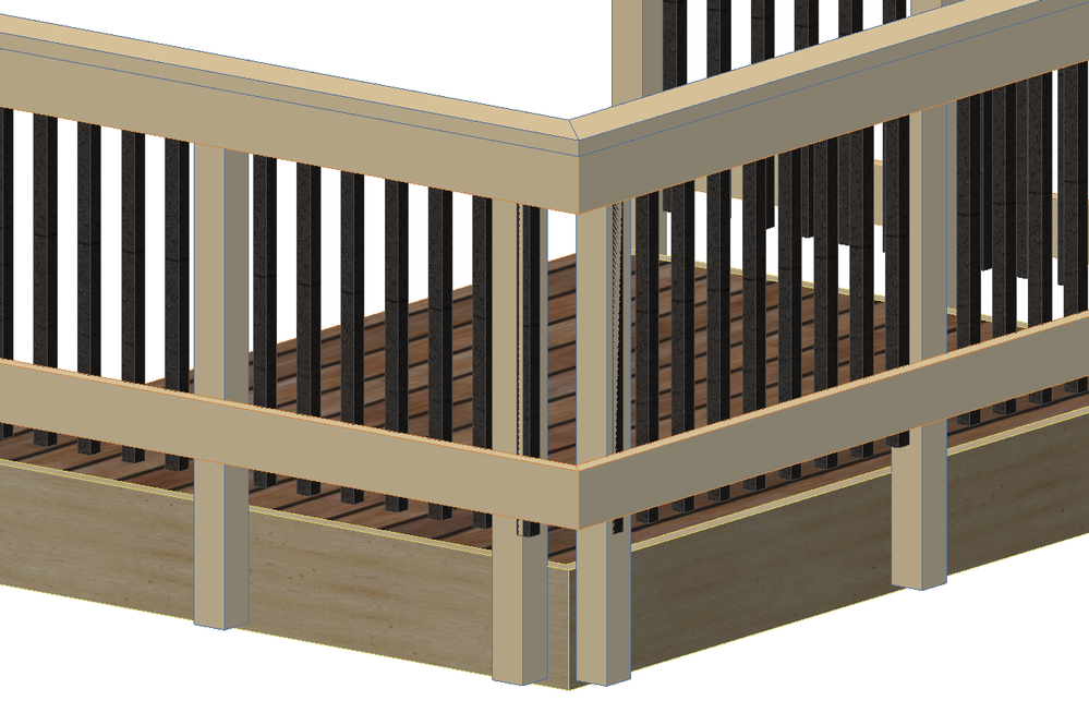

It would also be better if the Balusters "understood" the posts positions and spaced appropriately.
