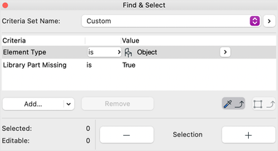

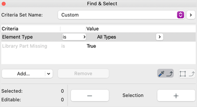

find and select criteria for Library Part Missing should be available for all types, since more than just objects use library parts.
7 Comments
I think you need to explicitly select one Element Type from the list, and then the "Library Part Missing" parameter will be enabled for element types where it is relevant.
But I guess your wish is for the parameter to be enabled even with the "All Types" option and know internally which element types it actually applies to.

yes, the find and select criteria, switching element type for each element using library parts would be more tedious than just visually scanning each view.

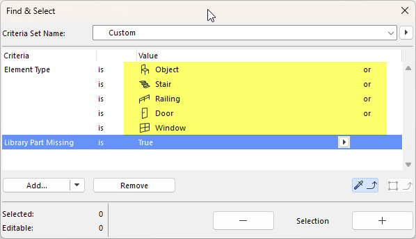

You can add extra criteria to include more element types that are object based.
Just make sure you use "OR".
We could really use parenthesis (brackets) as well, but that would be a separate wish.
As soon as you add an element type criteria for anything that does not apply to 'Library part Missing', then it will become grey and unavailable.

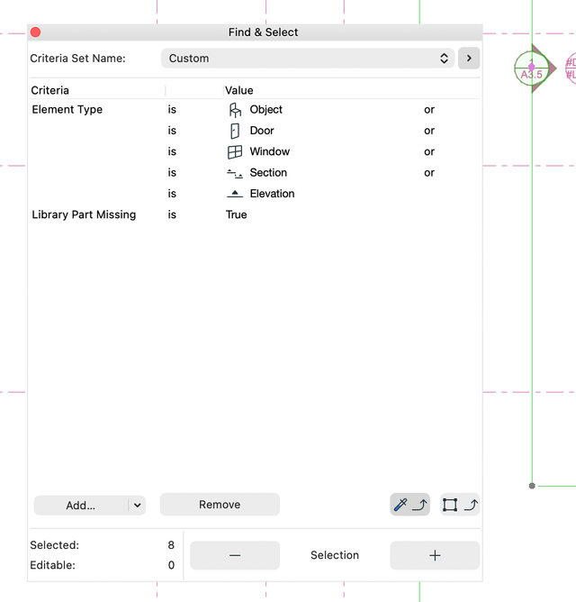

@Barry Kelly , that would be awesome IF; it weren't so unnecessarily complicated AND it seems to select elements that in fact do not have missing library parts or macros: 

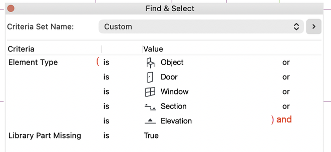

I think that is where we need the brackets.
So it seems my suggestion will not work.
Without them that is saying find any object or door or window or section or any elevation so long as the elevation has a missing library part.

Although I just tried it, not with missing object (as I don't have any missing at the moment), but for objects, doors, windows and section markers in a particular layer.
And the missing brackets has no effect.
The particular layer gets applied to each of the element types.
