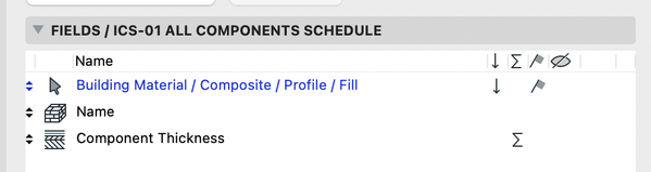

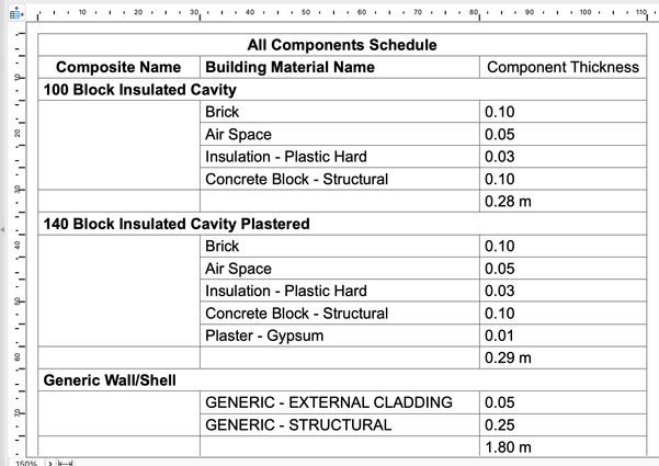

When I create a schedule, and make sure the sorting for Building Material Name field is not sorted, then they will show in the order they are in the composite. Can you show some images to this wish? Thanks.

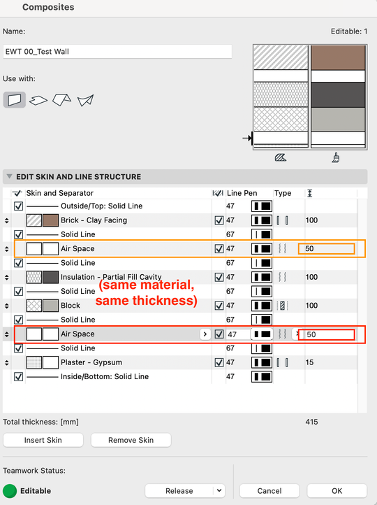

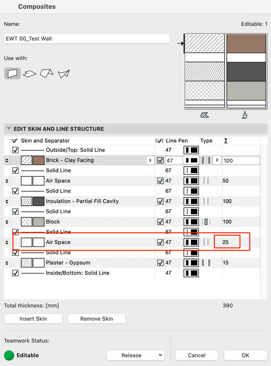

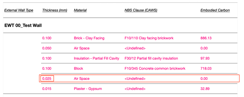

When two materials in a composite share unique properties, such as the same thickness, they are automatically combined in the schedule. This is particularly problematic when for example a layer of air is included in the composite. My workflow relies on this setup to allocate references to NBS clauses for primary construction elements, ensuring that every part of my project is fully specified.
Images 1.1 to 1.3 illustrate this issue, showing how material with identical properties are combined. In contrast, images 2.1 to 2.3 demonstrate the correct build-up when the material properties are no longer identical.

That is because you have ticked the option to 'Merge Uniform Items'
Un-tick that option or create unique names for each skin.
