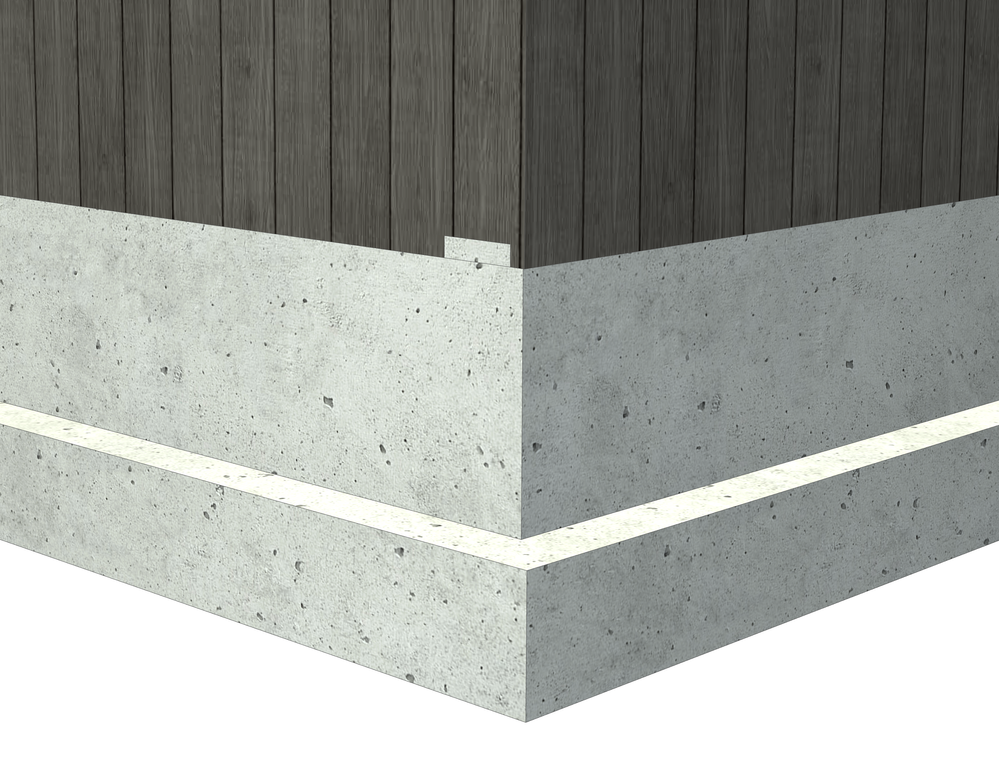

every project seems to be a trouble shooting adventure, where these are some of the "best possible results" for wall junctions. short of a complex profile column at every other wall juction, we just have to settle for 'good enough'.

It looks like in your last scenario, if the Intersection Priority Number of the Wall structure and the Slab structure is the same (either because they use the same Building Material, or because they use different Building Materials with the same Intersection Priority Number), then the Wall structure will be stronger and will not let the Slab structure extend further into the Wall. However, if you create another (maybe a duplicate) Building Material with a higher Intersection Priority Number for the Slab structure, then the Slab structure will be able to extend into the Wall beyond the Wall's structural skin.

but if I create a new building material, I get a line between the wall and the slab... which circles back to the original intent of this thread; that is, building material interactions need to be fully developed and realized into a complete solution so that we no longer need work-arounds.

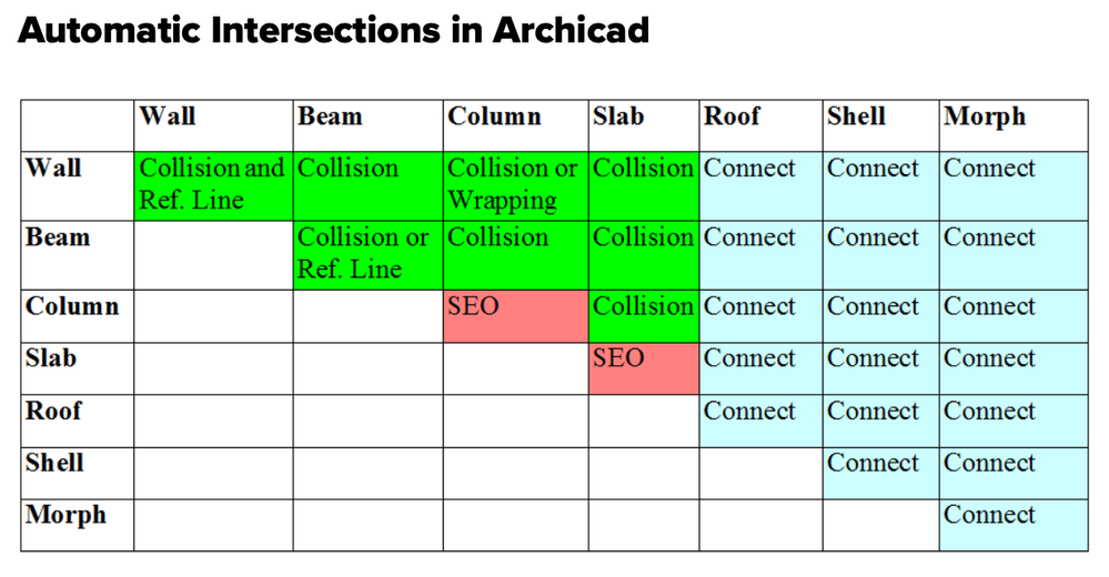

If memory serves BMats were introduced with AC17. At the time there was a debate as to whether Graphisoft should first introduce manual or automatic junctions. Obviously their choice was automatic. The more important bit of history is that we were promised manual junctions would shortly follow. They did not. Nor did completion of the project to include all parts of the model. This chart comes directly from Archicad Help and shows how half of the common junctions are not included at all.Intersection Chart.png
Even this embarrassing diagram does not tell the whole story. Meshes are not listed at all, nor are the errors generated when walls overlap each other vertically, as we often need to do for correct sections.Screenshot 2026-04-13 at 2.17.32 PM.png
Everything in Archicad flows from clean, water-tight modeling. As @Patrick M notes, most designers today expect that to extend to the skin level. That is what BMats and Priority Based Connections are supposed to be all about. Graphisoft needs to refocus a significant portion their efforts in this area, which should also include bringing SEOs—the ugly stepchild of intersection methods—in line with the more modern connections.
