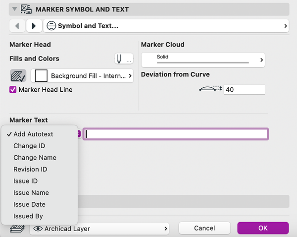

change maker calls it an issue:

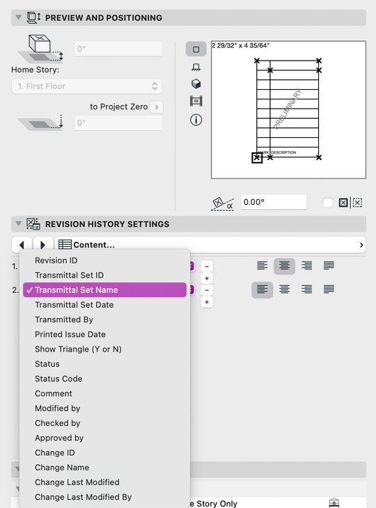

Revision list object calls it a transmittal:
OK, so that means the Change Marker user interface text needs to be updated. Layout Book and Revision History object are fine.
I modified the Change Markers so they display the correct text in the UI:
https://community.graphisoft.com/t5/Libraries-objects/Updated-Change-Markers/td-p/704898
