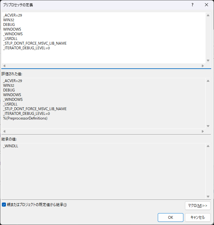

Thank you for checking.
The compiler version I'm using here is 19.44.35222.
Also, the debug build's _ITERATOR_DEBUG_LEVEL is set to 0 in the preprocessor definition, as shown in the attached image.
Thinking that there might be a problem with the project configuration, I ported the code provided in your sample "Communication_Manager," but I still get the -7003 error.
If possible, could you please provide a working sample project?
Thank you in advance.
