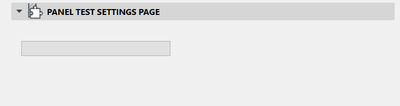

Hi All,
So I have attempted to dive into the world of API.  I'm managed to get over the hurdle of how to actually build the apx file, and have been trawling through the example files, but am still feeling very lost.
I am attempting to create a very simple API, that adds a panel to the Object Settings, that allows me to modify a Building Material parameter I have in an object.
I have been using the Panels_Test as the basis to start from and then found the attribute pickers in the DG_Test examples and have managed to get a panel with a 'picker', but I can't work how to associate that with a specific attribute type or parameter in the object.
Snippets from my GRC:
'STR#' IDS_SETTINGSPAGE_NAME "Panel test settings page" {
/* [  1] */		"Panel test settings page"
'GDLG'  InfoBoxPageId  TabPage  0    0  160   36  "" {
/* [ 1] */ UserControl        12   20  188   20  257  0x0004  0x1100  0		/* Building Material control	*/
'DLGH'  InfoBoxPageId  DLG_InfoBoxPageId {
1	""							UC257_0
I have come across the ACAPI_​Interface_​CreateAttributePicker function,  in the API reference, which seems to be what I am looking for, but I can't see that having being used anywhere in the DG_Functions example to modify from.
Is someone able to point me in the right direction?
Thanks,
Scott
