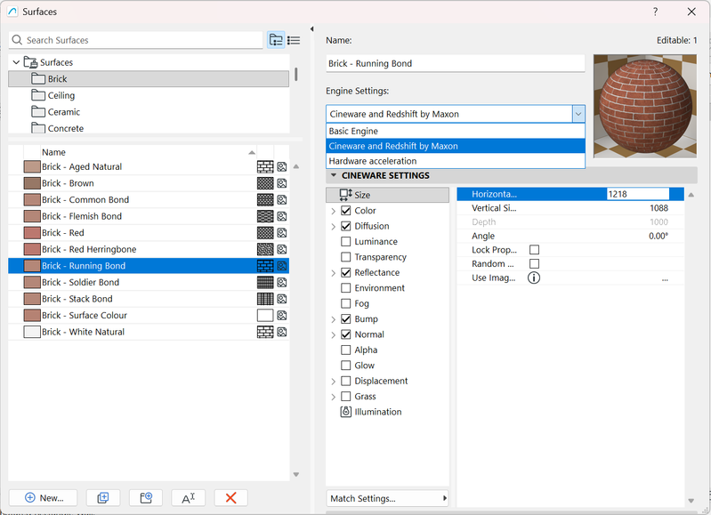

All the channels presented and explained in this section are found in the Surface parameter settings in ArchiCAD.
They can be accessed in Options > Element Attributes > Surfaces...
How can I retrieve the Cineware and Redshift by Maxon engine properties like Color, Fog, Glow, Grass, etc?

I've asked a developer about it.
Regards,
Tamás
4 weeks ago
I've got the reply from the developer, see it below.
Regards,
Tamás
With general API you cannot access this data.
There might be a work around, using ModelerAPI, but this works with a generated model only, which can be good for example if you want to export the model into a 3D format.
Check the DumpMaterialRenderingSettings function of the ModelAccess_Test example add-on of the API DevKit (Examples\ModelAccess_Test\Src\ModelAccess_Test_Writer.cpp). This can print the C4D parameters stored for the material attributes like this:

...However the mapping between the parameter names and the names displayed on the Surface Settings panel is not available here, these are part of the Cinema Rendering plugin only.
