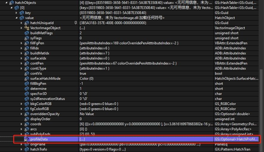

Hi there,
Does anyone meet the same issue that using Cmake template from GITHUB but not able ot get profile data?
Regards,
Mark

Hi @Viktor Kovacs ,
please find code in attachement.
The project is generated using cmake template on GitHub. Apart from adding grouping for newly added files, there are no other modifications.
The specific method is in the test() ,The data obtained from debugging is as follows
Regards,
Mark

Ok, I said I would be surprised if it would depend on the template. Now I'm surprised. 😀
Indeed, the example project configuration was different than the template. Example projects are always using ACAP_STAT.lib, even for debug builds. The template was using ACAP_STATD.lib for debug builds, and it seems it caused some runtime problems.
Now it is fixed in the GitHub template, please update your repository and now it should work. Thank you for the report.
