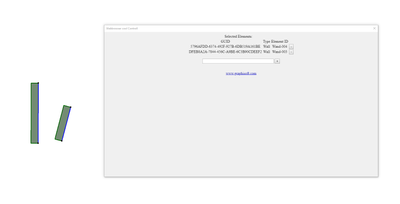

In the Browser Palette example you show how to load a URL into the CEF Browser.
Id like to pass my own local gui that is inside a html page to the Archicad Plugin. For that id like to use the method "LoadHTML" of the DGBrowser Module.
Im Struggling to convert my html as ressource and pass the string to the LoadHTML() method.
i know that i have to use the ACAPI_​Resource_​GetFixStr method, but i dont understand how i convert a file so i i have the needed chararray?

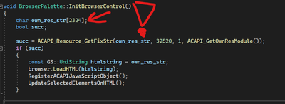

anyway, i found a workarround:
1. I convert with a c# skript the html code to a string that the ressource compiler likes.
2. that string directyl from the grc file seem to work. even with the javascript part.
code then is kinda easy. just get the fixed string from the ressource with ACAPI_Resource_GetFixString(), convert it to the archicad string and pass that to the LoadHtml method:
if the char array is not in the right size, archicad crashes without bug repport and anything, so be awere!! 😄
hope this helps for people like me that want to build a offline GUI with html
