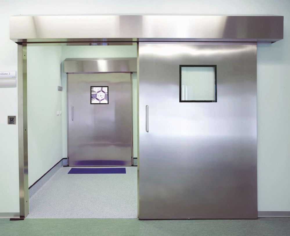

This is the door i'm trying to replicate. Can your tool do this?
ARCHICAD 28 INT
macOS Sequoia
Ok well at least you have been thorough, I will see what I have done to get the wallhole dimension.
Yes our door tool can easily do the configuration you are after and to the precise detail if you need it. We have cavity and face sliding doors with any number of moveable and fixed panels, We also have a component called the "Headtrack" for the face sliders. You can control the profiles and styles of all components  including adding the view panel to the door.
This is an image of one of our default configurations of the face slider.
To replicate your door you would only need to change the reveal detail, the door panel style, and the headtrack profile. For someone familiar with our Infinite Openings tool this would take about 4 minutes, for and expert user this would take less then a minute as they would have all their styles and profiles ready to apply in the catalogue feature.
