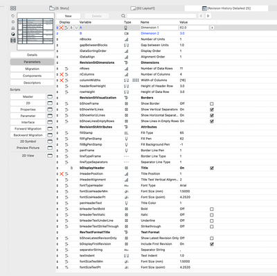

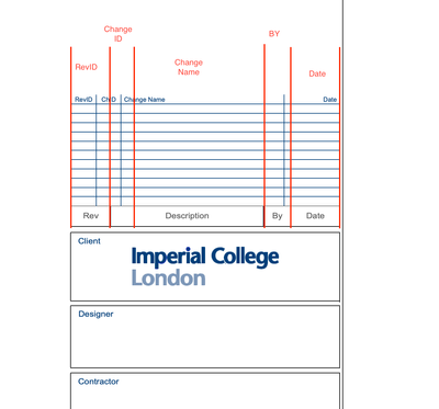

The first issue I have come across is I have to line up the 'Revision History Detailed 25' with their existing title block. I guess I need to adjust the settings in the GLD object? I have managed to open the object and get parameters, am I in the right way?. Could someone experienced on GDL coding give me some hints?

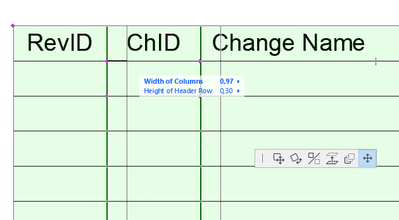

Activating the standard Revision History Detailed library part gives you some editable hotspots. With this you can re-arrange the column width. No GDL coding needed.
