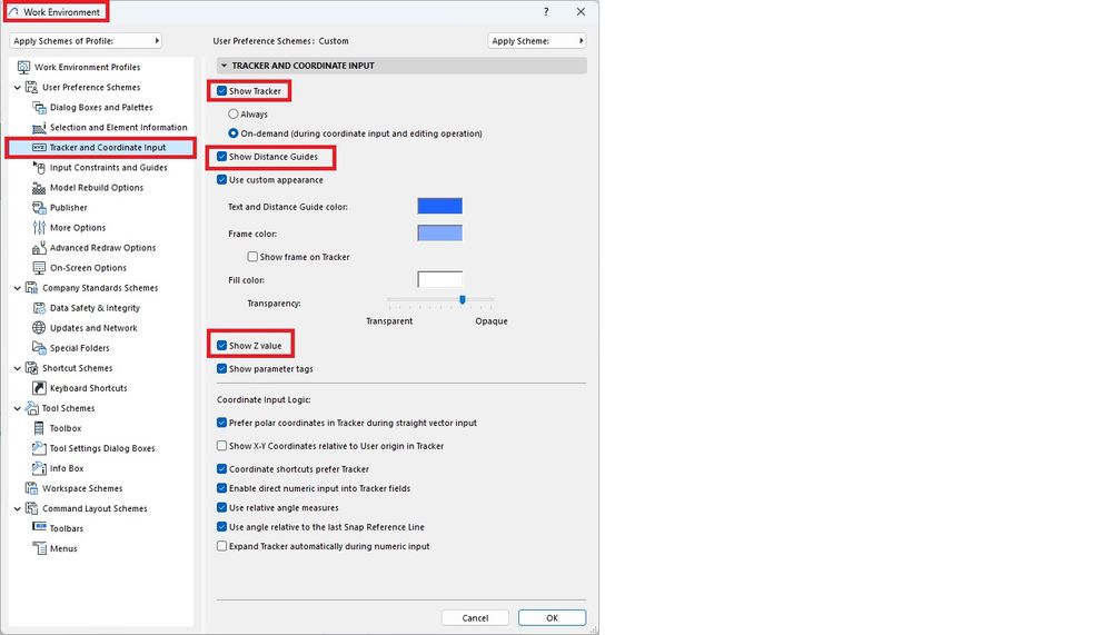

See my images below for instructions.  If you're not seeing the z coordinates when left clicking or selecting ther point, check your Options/Work Environment.../Tracker and Coordinate Input.  Make sure the Show Z Coordinate is checked.
Select the point in which you want to view the Z coordinate.  It should show up in the XYZ Tracker next to your cursor.  If you're still not seeing the Z coordinate, try and using the Tab key on the keyboard after you select the point.
Let me know if this helps you out.
