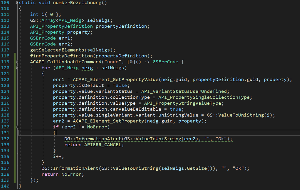

Hello Ben,
Thanks four your help, i tried it out and encapsulated the important bits of the addon:
the method "numberBezeichnung()" then gets called in MenuCommandHandler.
But when i execute the AddOn, no values get changed. To check if my selection works i added the line
    DG::InformationAlert(GS::ValueToUniString(selNeigs.GetSize()), "", "Ok");
which returns me after executing the addon the amount of the selected elements, which works.
Any idea why that still happens?
