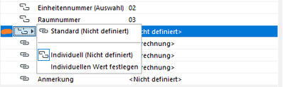

I want to change a property with an AddOn but for some reason my values always turn out undefined.
The property starts with its default value:
Sorry for the german bits, let met translate the important part:
Standard (Nicht definiert) = Standard (not definied)
Individuell (Wert) = Custom (value)
Als nicht definiert festgelegt = Set as not defined // Custom (not defined)

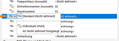

Now when i run the AddOn, the property gets set to "Custom (not defined)"
and the value is <Nicht definiert> (not defined).

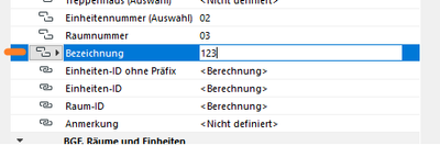

Now when i set the property to Individuellen Wert festlegen (Set custom value) and put in anything (like "123")
and then run my AddOn, the property gets set the way i want to.
But i can't find out how i can change the property to "Custom (value)", so that my property gets set by the AddOn, currently i only get <not defined>.

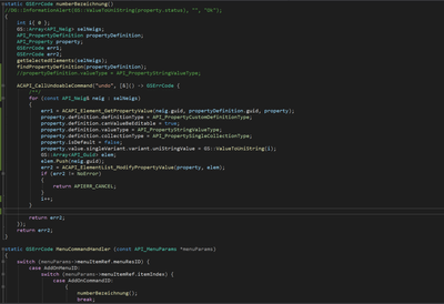

Here the important parts of my code:
I left out the functions "getSelectedElements" and "findPropertyDefinition" because they work and should have no impact on the <not defined> part.

I am nowhere near being C++ enabled, but on Archicad side I suspect the problem may be somewhere on an elevated level. Each property, which is not set, has the <not defined> default value status. You'll need to find a path to switch this status from "Undefined" to "Value" first. But I have no clue as to how this can be triggered. A screenshot of Property Manager for better explanation of the mentioned "elevated" level:
But in the first two of your screenshots it seems like you have managed to switch this status (API_PropertyCustomDefinitionType?), only the value remains in a <not defined> state.

Thanks for your help Misa_M.
I figured it was a problem like that and tried to find the property setting in the API doc, but couldnt find it.
What worked was to create a new property instead of copying and editing the old property
Seems like the old property had the <not defined> part baked in or something like that.
