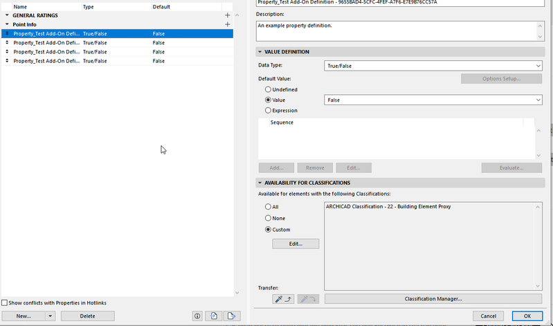

I'm using Archicad API 22 and I want to create a group and a property for the entire model, as shown in the image below:
I found the example property_Test, but it only creates a property for the selected object, not for the entire model. I’ve tried modifying it, but haven’t been successful.
Can anyone help me with this?

I think the code you want is in the Property_Text example. Take a look at the function SimpleTestPropertyDefinitions() in the file Property_Test.cpp, specifically where it calls ACAPI_Property_CreatePropertyDefinition to create a new property definition.

Thank you for answering my question, but I still haven't been able to do it. Could you help me by adjusting the code below?

The Archicad 22 API is a bit too old for me - I no longer have it installed. Are you able to work with anything more recent?
