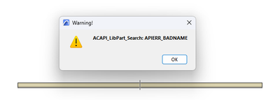

in AC25
In ac25, even though I changed the width from 900 to 1200, it does not work. But after resetting it, it's back to normal.
What's wrong?
After installing another window, this problem has changed to no problem.

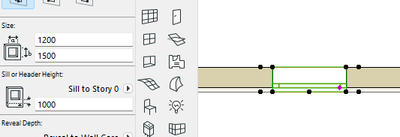

Can't you adjust the front and back and left and right of the wall like installing windows in Archicad?
If you tell me it's possible, I'll look for more. ^^
We are waiting for your help. ^^
AC27 on window 11
Yes it's possible.
You'll need to change the following three options:
openingBase.reflected
openingBase.oSide
openingBase.refSide
All of them can be true or false. So there are 8 combinations.
They are a bit confusing and I always forget how it works, so it's best to just try all the combinations.
Also be aware of the wall reference line direction, it can have an impact too if I remember correctly.
