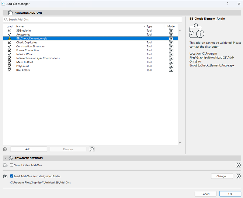

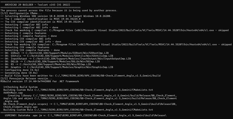

I really need your help; for the past year, I have been struggling—despite using every available piece of information, data, and three AI assistants—to get my custom add-on working. It runs without issues in the AC Demo version. I have inserted the ID numbers from https://archicadapi.graphisoft.com/profile/add-ons into the scripts, but I simply cannot get it to work. What am I doing wrong? Which specific data needs to be in which scripts to ensure the compilation produces a functional .apx add-on?
Compilation info:
Operating system used: Windows Win11 Pro 25H2
1 Solution
vtomaz
I found solution. Used Claude and made fresh start by creating template from archicad-addon-cmake. Claude solve it in 2 days 🙂
