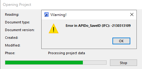

I have a process want to do:
1. Open File.pln.
2. Check File.pln is opened and save as IFC by "Do_Save_IfcFile".
3. Quit Archicad.
I have followed this topic below and try to save as ifc file inside "APINotify_Open" event.
But "Do_Save_IfcFile" throws error seems the file is not fully opened.
I am using Archicad 26. Any ways I can save as ifc after file is fully opened? Thanks a lot.

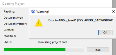

I'm afraid you cannot call ifc save function during the file opening operation. I'd suggest you to try APINotify_AllInputFinished.
HTH.
Thanks for your suggestion. I have tried "APINotify_AllInputFinished" but still fail with "APIERR_BADWINDOW" message.

LChen
Please try the following code to see whether you can save as ifc file:
#include	"SaveAndRestoreVariable.hpp"
#include	"ResourceIDs.h"
#define SAVEIFC			'SIFC'
// Main functions
GSErrCode __ACENV_CALL SaveIFCFunction(GSHandle /* params */, GSPtr /* resultData */, bool /* silentMode */)
	GSErrCode	lastErr = NoError;
	ACAPI_KeepInMemory(true);
	API_ProjectInfo		projectInfo = {};
	lastErr = ACAPI_Environment(APIEnv_ProjectID, &projectInfo);
	if (lastErr != NoError || projectInfo.untitled)
		return APIERR_NOPLAN;
	// Set the output IFC file's locations (it's beside the plan file)
	IO::Name	llName;
	projectInfo.location->GetLastLocalName(&llName);
	llName.DeleteExtension();
	llName.AppendExtension("ifc");
	projectInfo.location->SetLastLocalName(llName);
	// Get a suitable translator
	API_IFCTranslatorIdentifier firstTranslator;
	GS::Array<API_IFCTranslatorIdentifier> ifcExportTranslators;
	lastErr = ACAPI_IFC_GetIFCExportTranslatorsList (ifcExportTranslators);
	if (lastErr != NoError) {
		return APIERR_GENERAL;
	else {
		if (DBVERIFY(!ifcExportTranslators.IsEmpty()))
			firstTranslator = ifcExportTranslators.GetFirst();
	// Set the output parameters
	API_FileSavePars fileSave = {};
	fileSave.fileTypeID = APIFType_IfcFile;
	fileSave.file = projectInfo.location;
	// Set the output parameters for IFC
	API_SavePars_Ifc ifcPars = {};
	ifcPars.subType = API_IFC;
	ifcPars.elementsToIfcExport = API_EntireProject;
	ifcPars.translatorIdentifier = firstTranslator;
	ifcPars.elementsSet = nullptr;
	lastErr = ACAPI_Automate(APIDo_SaveID, &fileSave, &ifcPars);
	return lastErr;
static GSErrCode AllInputNotificationHandler(API_NotifyEventID notifID, Int32 /*param*/)
	if (notifID == APINotify_AllInputFinished) {
		API_ModulID mdid = {};
		mdid.developerID	= MDID_DEVELOPER_ID;
		mdid.localID		= MDID_LOCAL_ID;
		ACAPI_Command_CallFromEventLoop(&mdid, SAVEIFC, 1L, nullptr, false, nullptr);
	return NoError;
// Required functions
// Dependency definitions
API_AddonType	__ACENV_CALL	CheckEnvironment (API_EnvirParams* envir)
	RSGetIndString (&envir->addOnInfo.name, ID_ADDON_INFO, 1, ACAPI_GetOwnResModule());
	RSGetIndString (&envir->addOnInfo.description, ID_ADDON_INFO, 2, ACAPI_GetOwnResModule());
	return APIAddon_Preload;
}		// CheckEnvironment
// Interface definitions
GSErrCode	__ACENV_CALL	RegisterInterface (void)
	GSErrCode err = ACAPI_Register_SupportedService(SAVEIFC, 1L);
	return err;
}		// RegisterInterface
// Called when the Add-On has been loaded into memory
// to perform an operation
GSErrCode	__ACENV_CALL Initialize	(void)
	GSErrCode 	err = ACAPI_Install_ModulCommandHandler(SAVEIFC, 1L, SaveIFCFunction);
	err |= ACAPI_Notify_CatchProjectEvent(APINotify_AllInputFinished, AllInputNotificationHandler);
	return err;
}		// Initialize
// FreeData
//		called when the Add-On is going to be unloaded
GSErrCode __ACENV_CALL	FreeData (void)
	return NoError;
}		// FreeData
HTH.
It's work. Thank you so much.
