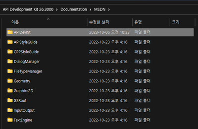

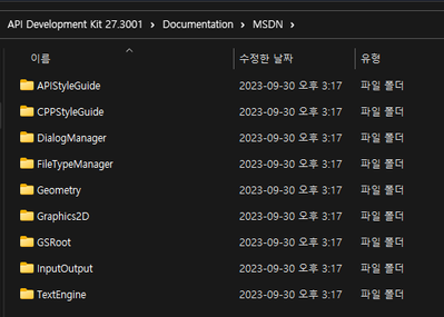

The apidevkit documentation has disappeared in API 27. Is this correct?

‎2023-10-06 07:46 AM
27 API documentation is now on the Developer's Site together with the new API - 27.3001

‎2023-10-06 08:14 AM
Q1. Are you talking about here?
Q2. Is there no apidevkit.chm file?

‎2023-10-06 08:30 AM
Developer Site: https://archicadapi.graphisoft.com/
There is no chm file -- not needed. The documentation is on the API Reference tab

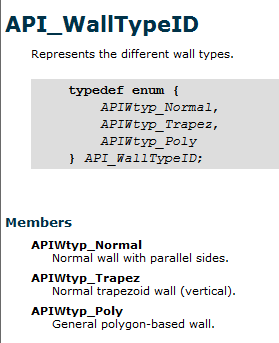

‎2023-10-09 02:37 AM
I think the chm file is easy to see.
The moment you click on API_WalltypeID, only dozens of posts are visible.
Fortunately, it was at the top, so I thought I should now turn my attention to the top.
That's all there is to the explanation.
It's better, right?
Archicad 27 C++ API (graphisoft.github.io)
