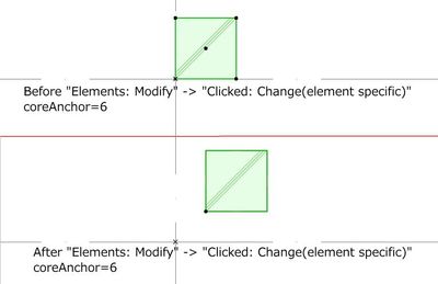

Use 'ACAPI_Element_Change()' on a column whose 'coreAnchor' is other than 4, it will be moved in parallel.
This can be confirmed with "Do_Change_ElemParameters()" in the SDK "Element_Test".
Is there a way to avoid this problem?

I'm not clear what the problem you mentioned. When you try to modify a column coreAnchor=4 to coreAnchor=6, it means the left bottom corner of column will be moved to the position of the center of colmun because you didn't change the origoPos.
HTH

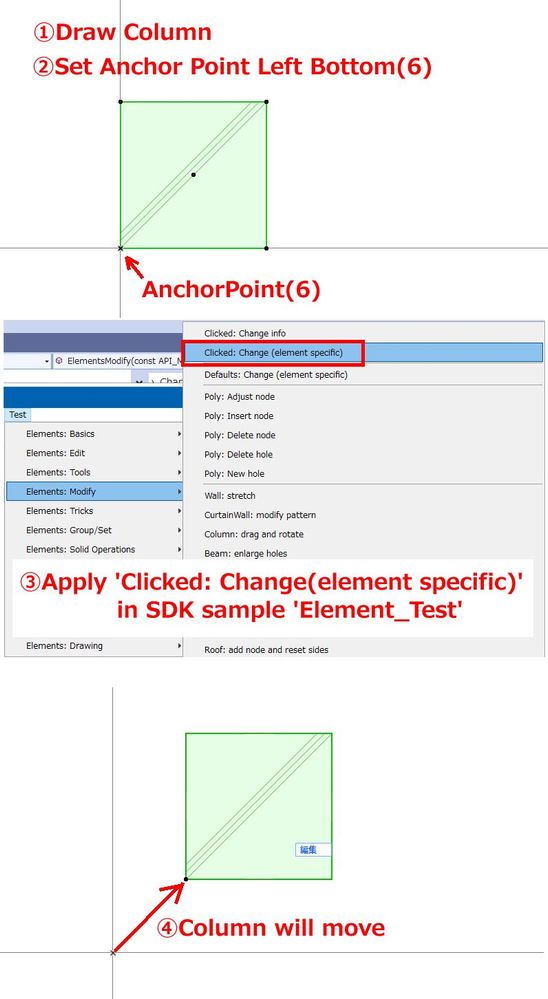

Let me explain the procedure.
1. Draw a column.
2. In the column settings(ctrl+T), change the anchor to something other than the center.
3. Execute "Do_Change_ElemParameters()" in the SDK "Element_Test" on the column.
4. The column will move.
(If the column anchor is at the center it not move.)

Sorry I couldn't reproduce this issue following your steps, I'd suggest you update AC27 to the latest release(27.2.1) and try again.
HTH
This issue occurs even in the latest environment.
Archicad solo 27 (version 27.2.1)(5031) / API Development Kit 27.3001 / Windows10

LChen
I see, I've asked our API developer to check whether it's an bug issue. As a workaround, I'd suggest you to shift origoPos to anchor point before calling ACAPI_Element_Change() if the anchor is not 4 in this case.
For example:
ACAPI_ELEMENT_MASK_SET(mask, API_ColumnType, origoPos);
element.column.origoPos.x (+-) = half of column width;
element.column.origoPos.y (+-) = half of column depth;
err = ACAPI_Element_Change();
 HTH.
