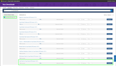

Hi paanjii2,
You can download older version via Visual Studio Older Downloads - 2019, 2017, 2015 & Previous Versions (microsoft.com)
This page will forward to your Visual studio subscription profile where you can download VS 2019 build tools (you don't need to install whole VS just build tools). While installing VS build tools just select "C++ desktop development" package - it's minimal what You'll need for successful build

Hey evryone.
I only have Visual Studio 2022 and i had some problems to get cmake create a VS Solution.
I installed the v142 toolsets and it still didnt work. i had to install the Visual Studio Build Tools 2019 and then it worked. Your Visual Studio Installer should look like this.VS.png
Then you can run normaly the cmake comand in vs2022 when you downloaded the template from there the https://github.com/Graphisoft/Archicad-addon-cmake
hope that helps someone like me that was stuck 😄
