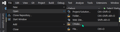

When I try to open cmakelist.txt for element_test I get an error.
When I try to open element_text I get an error.
What should I do?
AC27 on window 11

Since I don't know of anyone who speaks Korean here other than you, perhaps you could translate the error message?  There's no reason that any .txt file should not open, much less a makefile ... unless you have a permissions problem.

I'll try saying it another way:  why do you think anyone here can read your Korean screenshots and offer help?  Please translate any screenshots containing Korean, or if not possible, find a Korean C++ dev forum to seek assistance since you are new to C++ and the development process.
An active developer here might be able to address the between-the-lines issue of why you cannot just use CMake and had to install a Linux subsystem.

Can you share your CMakeLists.txt? (first 25 lines should help)

Change line# 6/7 to:
target_compile_options (${target} PUBLIC /W2 /wd4996 /Zc:wchar_t-)
You need "C++ CMake tools for Windows", which you already seem to have. You don't need a Linux Dev. Environment.

Did you try to "Rebuild All" after changing the CMakeLists.txt?

I succeeded in changing everything in visual studio to english. I hope to see you again.
