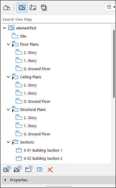

Hello bschwb,
Actually I want to list the viewmap of navigator and check whether the item can be deleted or not as below picture but still can't find our the way.
Not sure you have any suggestion or not.
Thanks in advance.
Which ones in the picture do you want to delete?
Automating Archicad with Add-Ons, GDL-Objects & Python Archi-XT.com
Hello bschwb,
From the given picture, if you select 'Floor Plans' then you can delete, but it's sub items such as story 1 you can't delete. I still can't find way to check whether the selected item can or can not delete from API function.
Thanks.
Solution
OK now I think I've understood. And I've tested it a bit.
It seems that you can't delete items which are part of a cloned folder as you've found out.
The cloned folders have itemType = API_UndefinedNavItem.
So you could check if an items parent has this item type.
To get an items parent you can use APINavigator_GetNavigatorParentItemID.
Hope that helps!
Hello bschwb,
You're right, It does what I am looking.
Thanks for suggestion.
