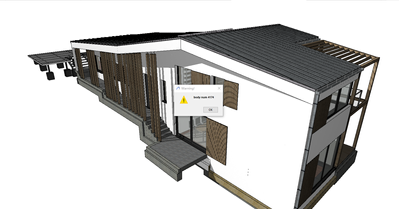

		API_WindowInfo      windowInfo;
		API_DatabaseInfo    origDB, planDB;
		API_Element         element;
		GS::Array<API_Guid> elemList;
		GSErrCode           err;
		BNZeroMemory(&planDB, sizeof(API_DatabaseInfo));
		planDB.typeID = APIWind_3DModelID;
		//ACAPI_Database(APIDb_GetCurrentDatabaseID, &origDB, nullptr);
		ACAPI_Database_ChangeCurrentDatabase(&planDB);
		BNZeroMemory(&windowInfo, sizeof(API_WindowInfo));
		windowInfo.typeID = APIWind_3DModelID;
		windowInfo.databaseUnId = planDB.databaseUnId;
		err = ACAPI_Window_ChangeWindow(&windowInfo);
	if (err == NoError)
		bool is_rebuild = true;
		ACAPI_View_Rebuild(&is_rebuild);
			void* origSight;
			GSErrCode	err;
			err = ACAPI_Sight_SelectSight(nullptr, &origSight);
		Int32 nbody;
		auto err = ACAPI_ModelAccess_GetNum(API_BodyID, &nbody);
		WriteReport_Alert("body num %d", nbody);
11 REPLIES 11

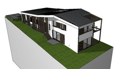

    1,This is the 3d model:
   I don't know if I called it at the wrong time, but I can get wall by this code:
GS::Array<API_Guid> wallList;
ACAPI_Element_GetElemList(API_WallID, &wallList);
2,I have confirmed that it returned NoError.
