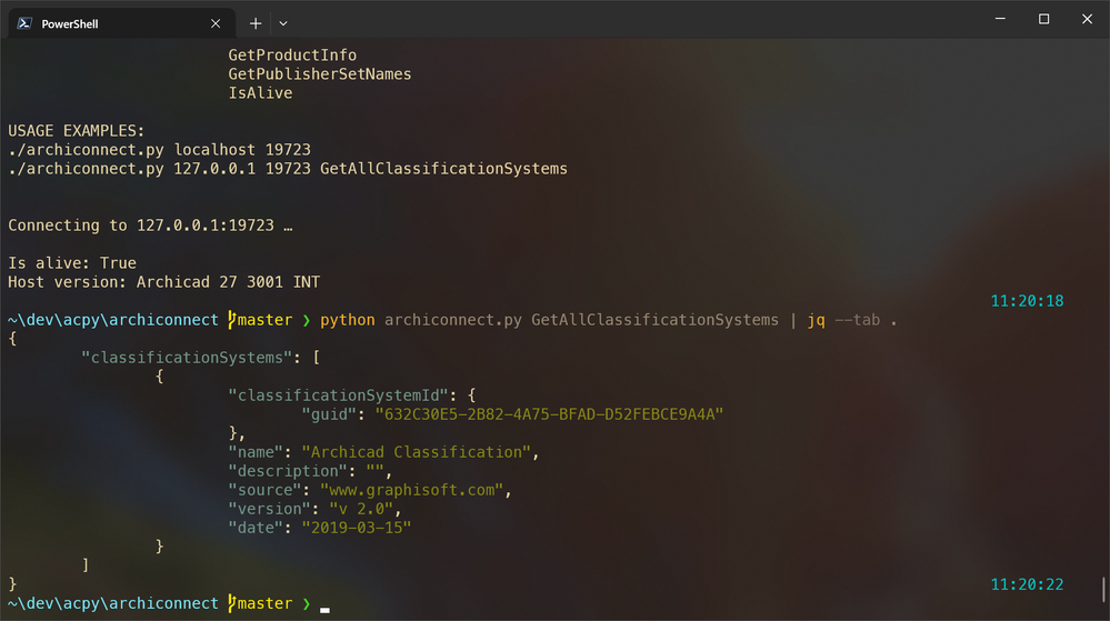

Dear Wenzel, you could try my script `archiconnect.py` which doesn't use the official Graphisoft archicad package, but could be used for connection testing.
How to test
Download latest archiconnect release from GitHub
Extract release and run `archiconnect.py` directly in Terminal or via Python:
./archiconnect.py
python archiconnect.py GetAllClassificationSystems
When running Archicad in background, you'll get output in Terminal:
Connecting to 127.0.0.1:19723 …
Is alive: True
Host version: Archicad 27 3001 INT
Creating and running PyInstaller package
Build package:
pyinstaller -F archiconnect.py
Run packed executable:
./dist/archiconnect
If this executable does or does not work in your environment, please post a short report here so we can investigate further.

Hi George and thank you for your reply!
Building and running your script works fine.
But it would still be nice to also use the official archicad package for this usecase.
