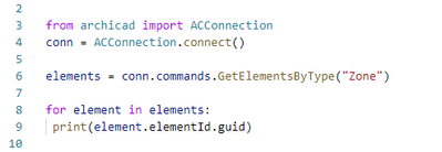

I've been starting to dive into the Python integration in order to put up a few routines regarding zone information in our firm. I'm a little bit familiar with the programming language itself, but I'm clueless on how to get the info from the elements.
I'm starting out with this, to get a list of all Zones in the project. Then there's a few things I need to be able to access in each of those zones. Which are:
- Zone name
- Layer to which they belong
- Calculated area
- Zone category
- Home Story index
- Home Story name
I'm not even sure if such information is available through the Python integration, though, in case they are, it would be good if I could, inside that 'element' loop assign them to variables so I can handle them across the code.

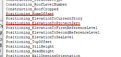

2022-03-16 04:47 AM
Updates on my own thread 😅
Apparently all those worked:
They were put out correctly at the listener:
Although, as it seems, there is no Built-in property available to get the Home Story Index. I think I'll handle that by doing a comparison between the elevation to Project Zero and the Project's Story elevation
Anyone has directions on how to obtain those Home Story info?
