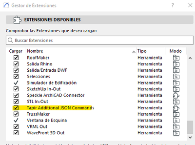

HI , ,i run the tapir addon but get this windows , im doing something wrong
Did you install the last version of python?
Archicad 27 - GDL - PYTHON
yes , and add the tapir extension
Guillermo1
Now it works ok!, just needed to add python to path!
