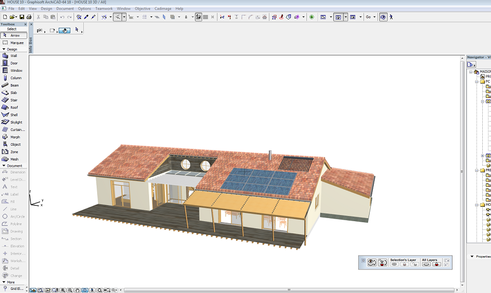

Ive found a way to get my Archicad 3D models into Google Cardboard and walk around.
Just WOW! its pretty incredible. Forget BIMX
I love it! THIS is the future

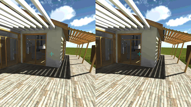

Here is an Apk file of a project imported into Unity3D, then compiled for Google Cardboard on Android.
Transfer onto your smartphone and install as an ordinary Android app. then run it and put your phone into your Google Cardboard. I've only tried it on my Galaxy Note 4 so cannot grantee performance on other smartphones.
If people are interested I can compile an iphone version.
To walk around the model, look down to activate and dis activate walking
https://mega.co.nz/#!D0ozTZLa!jjk6mhQbs8ei4prgCUczg9_OIkgS7uxB_Z4El8OtiVo
and this is the view on your smartphone with the side by side images that Google cardboard combines into one 3D image.
Of course you can walk into and explore the building model. The textures are imported from Archicad with the model.
