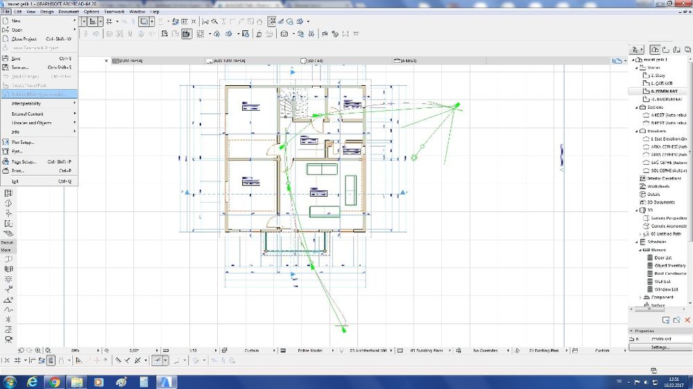

Hi .. my archicad 20 file menu does not have bimx hyper menu. Rather it looks dim. I can not make a choice. Could you help me with this.
ares997
