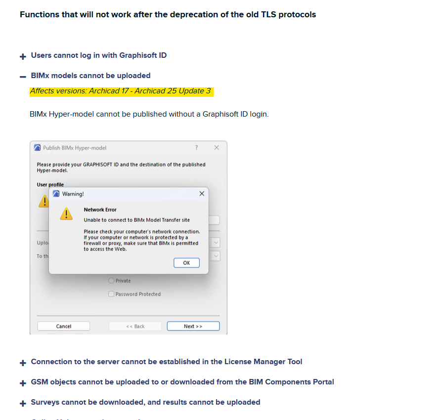

I´m having  this error:
I don't no what to do! I already turn off the firewall and doesn't work either.  Any solucion?

Hi, a little while ago there was an update for the ArchiCAD License Manager tool:
https://community.graphisoft.com/t5/Graphisoft-Insights/UPDATED-Old-TLS-protocols-to-be-deprecated-s...
In the detailed article they are showing the same screenshot that you posted, so there's a chance that your issue is related
https://community.graphisoft.com/t5/Installation-update/Security-Update-for-Archicad-22-25-and-Licen...

Sergio G
Thanks! it's working now😁
